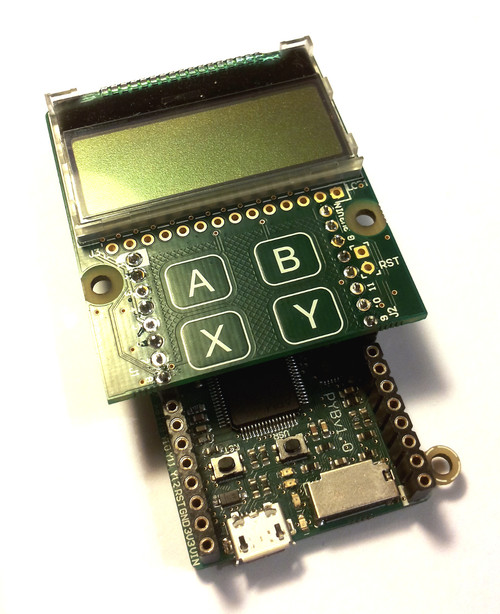

pyboard with LCD skin pyboard with LCD skin

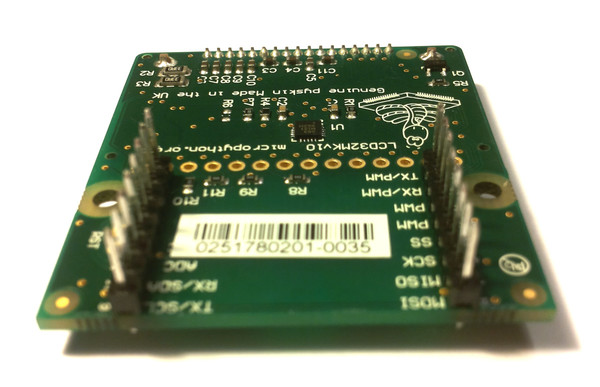

The following video shows how to solder the headers onto the LCD skin. At the end of the video, it shows you how to correctly connect the LCD skin to the pyboard.
For circuit schematics and datasheets for the components on the skin see The pyboard hardware.
3.1. Using the LCD
To get started using the LCD, try the following at the MicroPython prompt. Make sure the LCD skin is attached to the pyboard as pictured at the top of this page.
