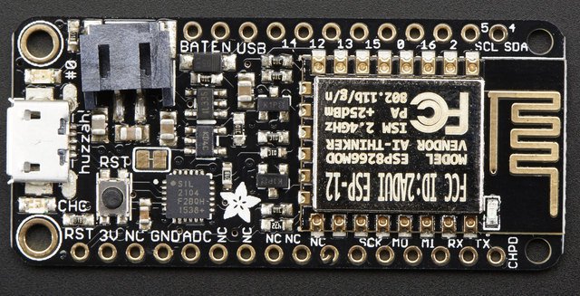

Adafruit Feather HUZZAH board
The Adafruit Feather HUZZAH board (image attribution: Adafruit).
