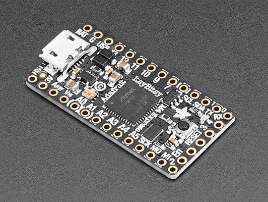

Adafruit ItsyBitsy M4 Express board
The Adafruit ItsyBitsy M4 Express board.
