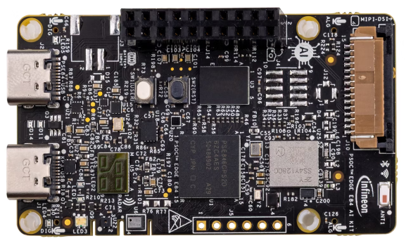

Quick reference for the PSOC™ Edge
KIT_PSE84_AI board
The PSOC™ Edge E84 AI Kit.
Below is a quick reference for PSOC™ Edge E84 boards. If it is your first time working with this port it may be useful to get an overview of the microcontroller:
