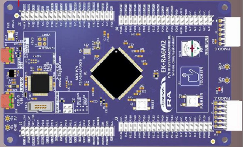

Renesas Evaluation Kit for RA6M2 MCU Group
The Renesas EK-RA6M2 board.
