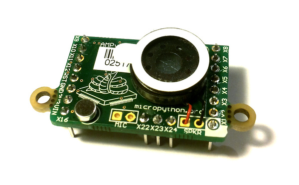

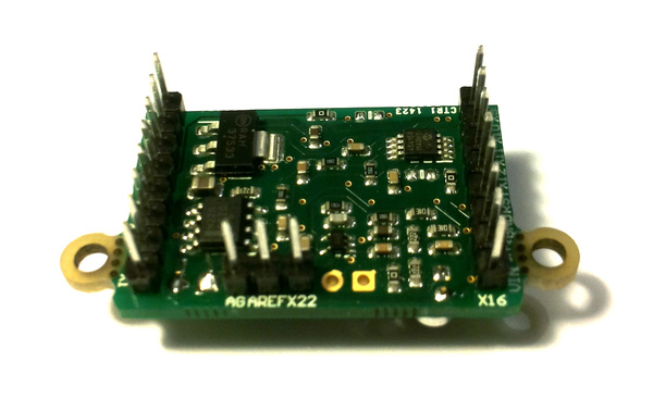

4. The AMP audio skin
Soldering and using the AMP audio skin.
AMP skin AMP skin
The following video shows how to solder the headers, microphone and speaker onto the AMP skin.
For circuit schematics and datasheets for the components on the skin see The pyboard hardware.
