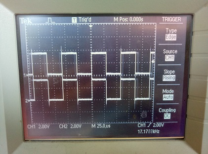

Output is:
0x0 0x0
0x30000 0x3
0x0 0x0
Pins 16 and 17 are switched synchronously:
../../_images/mem32_gpio_output.jpg
Same image on pins 32 and 33.
Note that pins 34-36 and 39 are inputs only. Also pins 1 and 3 are Tx, Rx of the REPL UART, pins 6-11 are connected to the built-in SPI flash.
