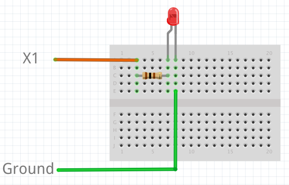

2.2. Connecting Things Up
For this tutorial, we will use the X1 pin. Connect one end of the resistor to X1, and the other end to the anode of the LED, which is the longer leg. Connect the cathode of the LED to ground.
../../_images/fading_leds_breadboard_fritzing.png
