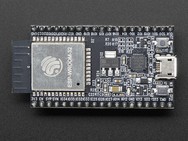

ESP32 board
The Espressif ESP32 Development Board (image attribution: Adafruit).
